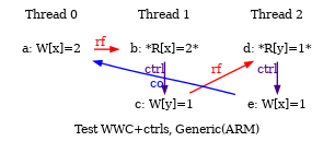

Test WWC+ctrls
ARM WWC+ctrls
"Rfe DpCtrldW Rfe DpCtrldW Wse"
Cycle=Rfe DpCtrldW Rfe DpCtrldW Wse
Prefetch=0:x=F,1:x=F,1:y=W,2:y=F,2:x=W
Com=Rf Rf Ws
Orig=Rfe DpCtrldW Rfe DpCtrldW Wse
%x0=x;
%x1=x; %y1=y;
%y2=y; %x2=x;
 P0           | P1           | P2           ;
 MOV R0,#2    | LDR R0,[%x1] | LDR R0,[%y2] ;
 STR R0,[%x0] | CMP R0,R0    | CMP R0,R0    ;
              | BNE LC00     | BNE LC01     ;
              | LC00:        | LC01:        ;
              | MOV R1,#1    | MOV R1,#1    ;
              | STR R1,[%y1] | STR R1,[%x2] ;
exists (1:R0=2 /\ 2:R0=1 /\ [x]=2)
