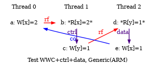

Test WWC+ctrl+data
ARM WWC+ctrl+data
"Rfe DpCtrldW Rfe DpDatadW Wse"
Cycle=Rfe DpDatadW Wse Rfe DpCtrldW
Prefetch=0:x=F,1:x=F,1:y=W,2:y=F,2:x=W
Com=Rf Rf Ws
Orig=Rfe DpCtrldW Rfe DpDatadW Wse
%x0=x;
%x1=x; %y1=y;
%y2=y; %x2=x;
 P0           | P1           | P2           ;
 MOV R0,#2    | LDR R0,[%x1] | LDR R0,[%y2] ;
 STR R0,[%x0] | CMP R0,R0    | EOR R1,R0,R0 ;
              | BNE LC00     | ADD R1,R1,#1 ;
              | LC00:        | STR R1,[%x2] ;
              | MOV R1,#1    |              ;
              | STR R1,[%y1] |              ;
exists (1:R0=2 /\ 2:R0=1 /\ [x]=2)
