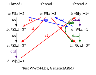

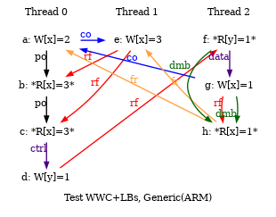

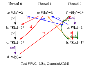

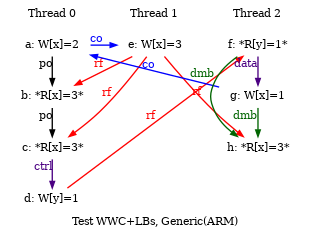

Test WWC+LBs
ARM WWC+LBs
"From DetourW PosRR DpCtrldW Rfe DpDatadW Wse, seen state features LB or WWC"
(* Observation on DETOUR0443 probably due to uniproc violation *)
Cycle=Rfe DpDatadW Wse DetourW PosRR DpCtrldW
Prefetch=0:x=F,0:y=W,1:y=F,1:x=W
Com=Rf Ws
Orig=DetourW PosRR DpCtrldW Rfe DpDatadW Wse
%x0=x; %y0=y;
%x1=x;
%y2=y; %x2=x;
 P0           | P1           | P2           ;
 MOV R0,#2    | MOV R0,#3    | LDR R0,[%y2] ;
 STR R0,[%x0] | STR R0,[%x1] | EOR R1,R0,R0 ;
 LDR R1,[%x0] |              | ADD R1,R1,#1 ;
 LDR R2,[%x0] |              | STR R1,[%x2] ;
 CMP R2,R2    |              | DMB          ;
 BNE LC00     |              | LDR R2,[%x2] ;
 LC00:        |              |              ;
 MOV R3,#1    |              |              ;
 STR R3,[%y0] |              |              ;
exists (0:R1=2 /\ 0:R2=3 /\ 2:R0=1 /\ 2:R2=1 /\ [x]=3) \/ (0:R1=2 /\ 0:R2=3 /\ 2:R0=1 /\ 2:R2=2 /\ [x]=3) \/ (0:R1=2 /\ 0:R2=3 /\ 2:R0=1 /\ 2:R2=3 /\ [x]=3) \/ (0:R1=3 /\ 0:R2=3 /\ 2:R0=1 /\ 2:R2=1 /\ [x]=3) \/ (0:R1=3 /\ 0:R2=3 /\ 2:R0=1 /\ 2:R2=2 /\ [x]=3) \/ (0:R1=3 /\ 0:R2=3 /\ 2:R0=1 /\ 2:R2=3 /\ [x]=3)
