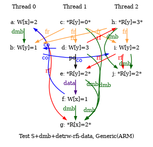

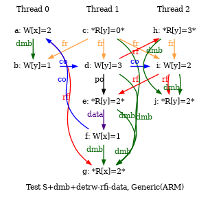

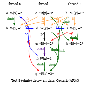

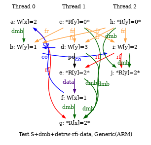

Test S+dmb+detrw-rfi-data
ARM S+dmb+detrw-rfi-data
"DMBdWW Rfe DetourRW Rfi DpDatadW Wse"
Cycle=Rfi DpDatadW Wse DMBdWW Rfe DetourRW
Prefetch=0:x=F,0:y=W,1:y=F,1:x=W
Com=Rf Ws
Orig=DMBdWW Rfe DetourRW Rfi DpDatadW Wse
%x0=x; %y0=y;
%y1=y; %x1=x;
%y2=y;
 P0           | P1           | P2           ;
 MOV R0,#2    | LDR R0,[%y1] | LDR R0,[%y2] ;
 STR R0,[%x0] | MOV R1,#3    | MOV R1,#2    ;
 DMB          | STR R1,[%y1] | STR R1,[%y2] ;
 MOV R1,#1    | LDR R2,[%y1] | DMB          ;
 STR R1,[%y0] | EOR R3,R2,R2 | LDR R2,[%y2] ;
              | ADD R3,R3,#1 |              ;
              | STR R3,[%x1] |              ;
              | DMB          |              ;
              | LDR R4,[%x1] |              ;
exists (1:R0=0 /\ 1:R2=2 /\ 1:R4=2 /\ 2:R0=0 /\ 2:R2=2 /\ [x]=2 /\ [y]=2) \/ (1:R0=0 /\ 1:R2=2 /\ 1:R4=2 /\ 2:R0=1 /\ 2:R2=2 /\ [x]=2 /\ [y]=2) \/ (1:R0=0 /\ 1:R2=2 /\ 1:R4=2 /\ 2:R0=3 /\ 2:R2=2 /\ [x]=2 /\ [y]=2)
