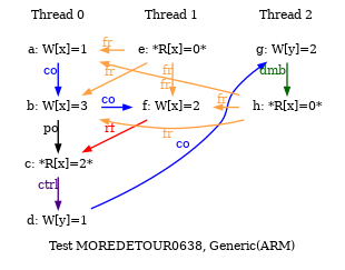

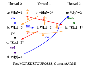

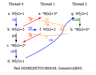

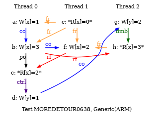

Test MOREDETOUR0638
ARM MOREDETOUR0638
"DetourWW Rfi DpCtrldW Wse DMBdWR Fre"
Cycle=Rfi DpCtrldW Wse DMBdWR Fre DetourWW
Prefetch=0:x=F,0:y=W,1:y=F,1:x=T
Com=Ws Fr
Orig=DetourWW Rfi DpCtrldW Wse DMBdWR Fre
%x0=x; %y0=y;
%x1=x;
%y2=y; %x2=x;
 P0           | P1           | P2           ;
 MOV R0,#1    | LDR R0,[%x1] | MOV R0,#2    ;
 STR R0,[%x0] | MOV R1,#2    | STR R0,[%y2] ;
 MOV R1,#3    | STR R1,[%x1] | DMB          ;
 STR R1,[%x0] |              | LDR R1,[%x2] ;
 LDR R2,[%x0] |              |              ;
 CMP R2,R2    |              |              ;
 BNE LC00     |              |              ;
 LC00:        |              |              ;
 MOV R3,#1    |              |              ;
 STR R3,[%y0] |              |              ;
exists (0:R2=2 /\ 1:R0=0 /\ 2:R1=0 /\ [x]=2 /\ [y]=2) \/ (0:R2=2 /\ 1:R0=0 /\ 2:R1=1 /\ [x]=2 /\ [y]=2) \/ (0:R2=2 /\ 1:R0=0 /\ 2:R1=3 /\ [x]=2 /\ [y]=2) \/ (0:R2=2 /\ 1:R0=1 /\ 2:R1=0 /\ [x]=2 /\ [y]=2) \/ (0:R2=2 /\ 1:R0=1 /\ 2:R1=1 /\ [x]=2 /\ [y]=2) \/ (0:R2=2 /\ 1:R0=1 /\ 2:R1=3 /\ [x]=2 /\ [y]=2) \/ (0:R2=2 /\ 1:R0=3 /\ 2:R1=0 /\ [x]=2 /\ [y]=2) \/ (0:R2=2 /\ 1:R0=3 /\ 2:R1=1 /\ [x]=2 /\ [y]=2) \/ (0:R2=2 /\ 1:R0=3 /\ 2:R1=3 /\ [x]=2 /\ [y]=2)
