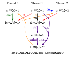

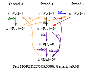

Test MOREDETOUR0385
ARM MOREDETOUR0385
"DMBdWR Fre DetourW DpCtrldR DpCtrlIsbdR Fre"
Cycle=Fre DetourW DpCtrldR DpCtrlIsbdR Fre DMBdWR
Prefetch=0:x=F,0:y=T,1:y=F,1:x=T
Com=Fr Fr
Orig=DMBdWR Fre DetourW DpCtrldR DpCtrlIsbdR Fre
%x0=x; %y0=y;
%y1=y; %z1=z; %x1=x;
%y2=y;
 P0           | P1           | P2           ;
 MOV R0,#1    | MOV R0,#1    | MOV R0,#2    ;
 STR R0,[%x0] | STR R0,[%y1] | STR R0,[%y2] ;
 DMB          | LDR R1,[%y1] |              ;
 LDR R1,[%y0] | CMP R1,R1    |              ;
              | BNE LC00     |              ;
              | LC00:        |              ;
              | LDR R2,[%z1] |              ;
              | CMP R2,R2    |              ;
              | BNE LC01     |              ;
              | LC01:        |              ;
              | ISB          |              ;
              | LDR R3,[%x1] |              ;
exists (0:R1=0 /\ 1:R1=2 /\ 1:R3=0) \/ (0:R1=1 /\ 1:R1=2 /\ 1:R3=0)
