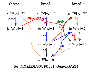

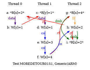

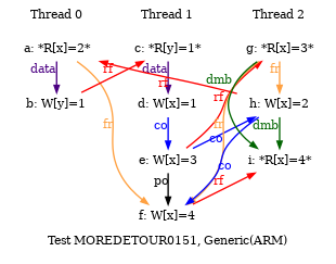

Test MOREDETOUR0151
ARM MOREDETOUR0151
"DpDatadW Rfe DpDatadW DetourWW PosWW Rfe"
Cycle=Rfe DpDatadW Rfe DpDatadW DetourWW PosWW
Prefetch=0:x=F,0:y=W,1:y=F,1:x=W
Com=Rf Rf
Orig=DpDatadW Rfe DpDatadW DetourWW PosWW Rfe
%x0=x; %y0=y;
%y1=y; %x1=x;
%x2=x;
 P0           | P1           | P2           ;
 LDR R0,[%x0] | LDR R0,[%y1] | LDR R0,[%x2] ;
 EOR R1,R0,R0 | EOR R1,R0,R0 | MOV R1,#2    ;
 ADD R1,R1,#1 | ADD R1,R1,#1 | STR R1,[%x2] ;
 STR R1,[%y0] | STR R1,[%x1] | DMB          ;
              | MOV R2,#3    | LDR R2,[%x2] ;
              | STR R2,[%x1] |              ;
              | MOV R3,#4    |              ;
              | STR R3,[%x1] |              ;
exists (0:R0=2 /\ 1:R0=1 /\ 2:R0=1 /\ 2:R2=2) \/ (0:R0=2 /\ 1:R0=1 /\ 2:R0=1 /\ 2:R2=3) \/ (0:R0=2 /\ 1:R0=1 /\ 2:R0=1 /\ 2:R2=4) \/ (0:R0=2 /\ 1:R0=1 /\ 2:R0=3 /\ 2:R2=2) \/ (0:R0=2 /\ 1:R0=1 /\ 2:R0=3 /\ 2:R2=4) \/ (0:R0=2 /\ 1:R0=1 /\ 2:R0=4 /\ 2:R2=2) \/ (0:R0=3 /\ 1:R0=1 /\ 2:R0=0 /\ 2:R2=1) \/ (0:R0=3 /\ 1:R0=1 /\ 2:R0=0 /\ 2:R2=2) \/ (0:R0=3 /\ 1:R0=1 /\ 2:R0=0 /\ 2:R2=3) \/ (0:R0=3 /\ 1:R0=1 /\ 2:R0=0 /\ 2:R2=4) \/ (0:R0=3 /\ 1:R0=1 /\ 2:R0=1 /\ 2:R2=2) \/ (0:R0=3 /\ 1:R0=1 /\ 2:R0=1 /\ 2:R2=3) \/ (0:R0=3 /\ 1:R0=1 /\ 2:R0=1 /\ 2:R2=4) \/ (0:R0=3 /\ 1:R0=1 /\ 2:R0=3 /\ 2:R2=2) \/ (0:R0=3 /\ 1:R0=1 /\ 2:R0=3 /\ 2:R2=4) \/ (0:R0=3 /\ 1:R0=1 /\ 2:R0=4 /\ 2:R2=2) \/ (0:R0=4 /\ 1:R0=1 /\ 2:R0=0 /\ 2:R2=1) \/ (0:R0=4 /\ 1:R0=1 /\ 2:R0=0 /\ 2:R2=2) \/ (0:R0=4 /\ 1:R0=1 /\ 2:R0=0 /\ 2:R2=3) \/ (0:R0=4 /\ 1:R0=1 /\ 2:R0=0 /\ 2:R2=4) \/ (0:R0=4 /\ 1:R0=1 /\ 2:R0=1 /\ 2:R2=2) \/ (0:R0=4 /\ 1:R0=1 /\ 2:R0=1 /\ 2:R2=3) \/ (0:R0=4 /\ 1:R0=1 /\ 2:R0=1 /\ 2:R2=4) \/ (0:R0=4 /\ 1:R0=1 /\ 2:R0=3 /\ 2:R2=2) \/ (0:R0=4 /\ 1:R0=1 /\ 2:R0=3 /\ 2:R2=4) \/ (0:R0=4 /\ 1:R0=1 /\ 2:R0=4 /\ 2:R2=2)
