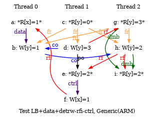

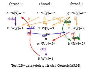

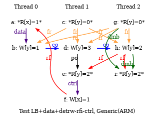

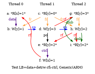

Test LB+data+detrw-rfi-ctrl
ARM LB+data+detrw-rfi-ctrl
"DpDatadW Rfe DetourRW Rfi DpCtrldW Rfe"
Cycle=Rfi DpCtrldW Rfe DpDatadW Rfe DetourRW
Prefetch=0:x=F,0:y=W,1:y=F,1:x=W
Com=Rf Rf
Orig=DpDatadW Rfe DetourRW Rfi DpCtrldW Rfe
%x0=x; %y0=y;
%y1=y; %x1=x;
%y2=y;
 P0           | P1           | P2           ;
 LDR R0,[%x0] | LDR R0,[%y1] | LDR R0,[%y2] ;
 EOR R1,R0,R0 | MOV R1,#3    | MOV R1,#2    ;
 ADD R1,R1,#1 | STR R1,[%y1] | STR R1,[%y2] ;
 STR R1,[%y0] | LDR R2,[%y1] | DMB          ;
              | CMP R2,R2    | LDR R2,[%y2] ;
              | BNE LC00     |              ;
              | LC00:        |              ;
              | MOV R3,#1    |              ;
              | STR R3,[%x1] |              ;
exists (0:R0=1 /\ 1:R0=0 /\ 1:R2=2 /\ 2:R0=0 /\ 2:R2=2 /\ [y]=2) \/ (0:R0=1 /\ 1:R0=0 /\ 1:R2=2 /\ 2:R0=1 /\ 2:R2=2 /\ [y]=2) \/ (0:R0=1 /\ 1:R0=0 /\ 1:R2=2 /\ 2:R0=3 /\ 2:R2=2 /\ [y]=2)
