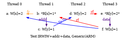

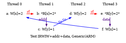

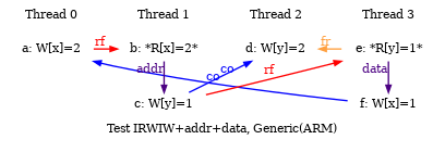

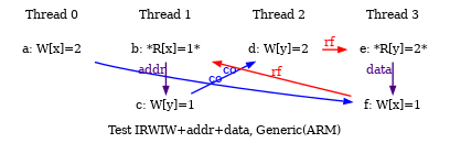

 P0           | P1              | P2           | P3           ;
 MOV R0,#2    | LDR R0,[%x1]    | MOV R0,#2    | LDR R0,[%y3] ;
 STR R0,[%x0] | EOR R1,R0,R0    | STR R0,[%y2] | EOR R1,R0,R0 ;
              | MOV R2,#1       |              | ADD R1,R1,#1 ;
              | STR R2,[R1,%y1] |              | STR R1,[%x3] ;
exists (1:R0=1 /\ 3:R0=2 /\ [x]=1 /\ [y]=2) \/ (1:R0=1 /\ 3:R0=2 /\ [x]=2 /\ [y]=2) \/ (1:R0=2 /\ 3:R0=1 /\ [x]=2 /\ [y]=1) \/ (1:R0=2 /\ 3:R0=1 /\ [x]=2 /\ [y]=2) \/ (1:R0=2 /\ 3:R0=2 /\ [x]=2 /\ [y]=2)
