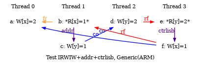

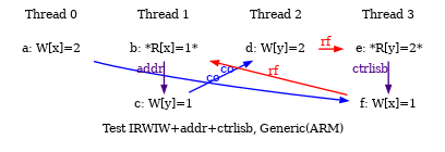

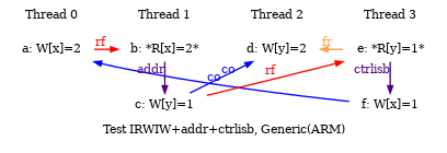

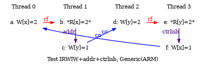

Test IRWIW+addr+ctrlisb
ARM IRWIW+addr+ctrlisb
"Rfe DpAddrdW Wse Rfe DpCtrlIsbdW Wse"
Cycle=Rfe DpAddrdW Wse Rfe DpCtrlIsbdW Wse
Prefetch=0:x=F,1:x=F,1:y=W,2:y=F,3:y=F,3:x=W
Com=Rf Ws Rf Ws
Orig=Rfe DpAddrdW Wse Rfe DpCtrlIsbdW Wse
%x0=x;
%x1=x; %y1=y;
%y2=y;
%y3=y; %x3=x;
 P0           | P1              | P2           | P3           ;
 MOV R0,#2    | LDR R0,[%x1]    | MOV R0,#2    | LDR R0,[%y3] ;
 STR R0,[%x0] | EOR R1,R0,R0    | STR R0,[%y2] | CMP R0,R0    ;
              | MOV R2,#1       |              | BNE LC00     ;
              | STR R2,[R1,%y1] |              | LC00:        ;
              |                 |              | ISB          ;
              |                 |              | MOV R1,#1    ;
              |                 |              | STR R1,[%x3] ;
exists (1:R0=1 /\ 3:R0=2 /\ [x]=1 /\ [y]=2) \/ (1:R0=1 /\ 3:R0=2 /\ [x]=2 /\ [y]=2) \/ (1:R0=2 /\ 3:R0=1 /\ [x]=2 /\ [y]=1) \/ (1:R0=2 /\ 3:R0=1 /\ [x]=2 /\ [y]=2) \/ (1:R0=2 /\ 3:R0=2 /\ [x]=2 /\ [y]=2)
