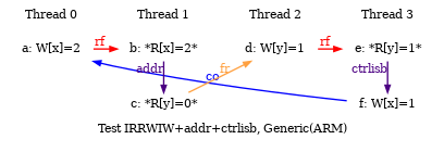

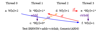

Test IRRWIW+addr+ctrlisb
ARM IRRWIW+addr+ctrlisb
"Rfe DpAddrdR Fre Rfe DpCtrlIsbdW Wse"
Cycle=Rfe DpAddrdR Fre Rfe DpCtrlIsbdW Wse
Prefetch=0:x=F,1:x=F,1:y=T,2:y=T,3:y=F,3:x=W
Com=Rf Fr Rf Ws
Orig=Rfe DpAddrdR Fre Rfe DpCtrlIsbdW Wse
%x0=x;
%x1=x; %y1=y;
%y2=y;
%y3=y; %x3=x;
 P0           | P1              | P2           | P3           ;
 MOV R0,#2    | LDR R0,[%x1]    | MOV R0,#1    | LDR R0,[%y3] ;
 STR R0,[%x0] | EOR R1,R0,R0    | STR R0,[%y2] | CMP R0,R0    ;
              | LDR R2,[R1,%y1] |              | BNE LC00     ;
              |                 |              | LC00:        ;
              |                 |              | ISB          ;
              |                 |              | MOV R1,#1    ;
              |                 |              | STR R1,[%x3] ;
exists (1:R0=1 /\ 1:R2=0 /\ 3:R0=1 /\ [x]=1) \/ (1:R0=1 /\ 1:R2=0 /\ 3:R0=1 /\ [x]=2) \/ (1:R0=2 /\ 1:R2=0 /\ 3:R0=1 /\ [x]=2)
