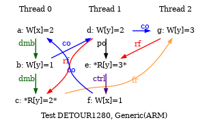

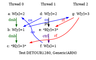

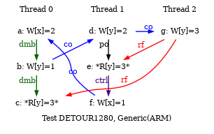

Test DETOUR1280
ARM DETOUR1280
"DMBdWW Wse DetourW DpCtrldW Wse"
Cycle=Wse DetourW DpCtrldW Wse DMBdWW
Prefetch=0:x=F,0:y=W,1:y=F,1:x=W
Com=Ws Ws
Orig=DMBdWW Wse DetourW DpCtrldW Wse
%x0=x; %y0=y;
%y1=y; %x1=x;
%y2=y;
 P0           | P1           | P2           ;
 MOV R0,#2    | MOV R0,#2    | MOV R0,#3    ;
 STR R0,[%x0] | STR R0,[%y1] | STR R0,[%y2] ;
 DMB          | LDR R1,[%y1] |              ;
 MOV R1,#1    | CMP R1,R1    |              ;
 STR R1,[%y0] | BNE LC00     |              ;
 DMB          | LC00:        |              ;
 LDR R2,[%y0] | MOV R2,#1    |              ;
              | STR R2,[%x1] |              ;
exists (0:R2=2 /\ 1:R1=3 /\ [x]=2) \/ (0:R2=3 /\ 1:R1=3 /\ [x]=2)
