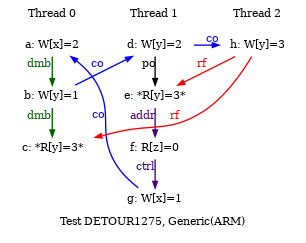

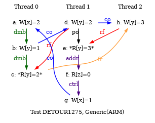

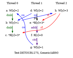

Test DETOUR1275
ARM DETOUR1275
"DMBdWW Wse DetourW DpAddrdR DpCtrldW Wse"
Cycle=Wse DetourW DpAddrdR DpCtrldW Wse DMBdWW
Prefetch=0:x=F,0:y=W,1:y=F,1:x=W
Com=Ws Ws
Orig=DMBdWW Wse DetourW DpAddrdR DpCtrldW Wse
%x0=x; %y0=y;
%y1=y; %z1=z; %x1=x;
%y2=y;
 P0           | P1              | P2           ;
 MOV R0,#2    | MOV R0,#2       | MOV R0,#3    ;
 STR R0,[%x0] | STR R0,[%y1]    | STR R0,[%y2] ;
 DMB          | LDR R1,[%y1]    |              ;
 MOV R1,#1    | EOR R2,R1,R1    |              ;
 STR R1,[%y0] | LDR R3,[R2,%z1] |              ;
 DMB          | CMP R3,R3       |              ;
 LDR R2,[%y0] | BNE LC00        |              ;
              | LC00:           |              ;
              | MOV R4,#1       |              ;
              | STR R4,[%x1]    |              ;
exists (0:R2=2 /\ 1:R1=3 /\ [x]=2) \/ (0:R2=3 /\ 1:R1=3 /\ [x]=2)
