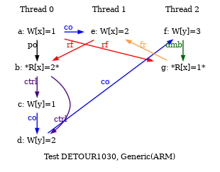

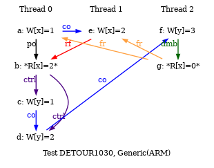

Test DETOUR1030
ARM DETOUR1030
"DetourW DpCtrldW PosWW Wse DMBdWR Fre"
Cycle=Fre DetourW DpCtrldW PosWW Wse DMBdWR
Prefetch=0:x=F,0:y=W,1:y=F,1:x=T
Com=Ws Fr
Orig=DetourW DpCtrldW PosWW Wse DMBdWR Fre
%x0=x; %y0=y;
%x1=x;
%y2=y; %x2=x;
 P0           | P1           | P2           ;
 MOV R0,#1    | MOV R0,#2    | MOV R0,#3    ;
 STR R0,[%x0] | STR R0,[%x1] | STR R0,[%y2] ;
 LDR R1,[%x0] |              | DMB          ;
 CMP R1,R1    |              | LDR R1,[%x2] ;
 BNE LC00     |              |              ;
 LC00:        |              |              ;
 MOV R2,#1    |              |              ;
 STR R2,[%y0] |              |              ;
 MOV R3,#2    |              |              ;
 STR R3,[%y0] |              |              ;
exists (0:R1=2 /\ 2:R1=0 /\ [y]=3) \/ (0:R1=2 /\ 2:R1=1 /\ [y]=3)
