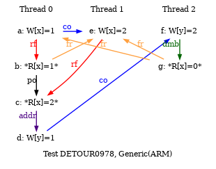

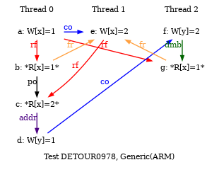

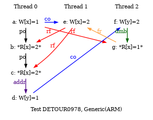

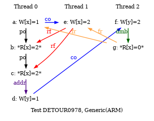

Test DETOUR0978
ARM DETOUR0978
"PosWR DetourR DpAddrdW Wse DMBdWR Fre"
Cycle=Fre PosWR DetourR DpAddrdW Wse DMBdWR
Prefetch=0:x=F,0:y=W,1:y=F,1:x=T
Com=Ws Fr
Orig=PosWR DetourR DpAddrdW Wse DMBdWR Fre
%x0=x; %y0=y;
%x1=x;
%y2=y; %x2=x;
 P0              | P1           | P2           ;
 MOV R0,#1       | MOV R0,#2    | MOV R0,#2    ;
 STR R0,[%x0]    | STR R0,[%x1] | STR R0,[%y2] ;
 LDR R1,[%x0]    |              | DMB          ;
 LDR R2,[%x0]    |              | LDR R1,[%x2] ;
 EOR R3,R2,R2    |              |              ;
 MOV R4,#1       |              |              ;
 STR R4,[R3,%y0] |              |              ;
exists (0:R1=1 /\ 0:R2=2 /\ 2:R1=0 /\ [y]=2) \/ (0:R1=1 /\ 0:R2=2 /\ 2:R1=1 /\ [y]=2) \/ (0:R1=2 /\ 0:R2=2 /\ 2:R1=0 /\ [y]=2) \/ (0:R1=2 /\ 0:R2=2 /\ 2:R1=1 /\ [y]=2)
