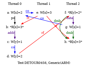

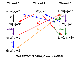

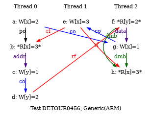

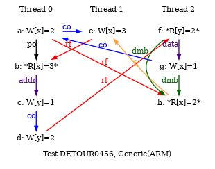

Test DETOUR0456
ARM DETOUR0456
"DetourW DpAddrdW PosWW Rfe DpDatadW Wse"
Cycle=Rfe DpDatadW Wse DetourW DpAddrdW PosWW
Prefetch=0:x=F,0:y=W,1:y=F,1:x=W
Com=Rf Ws
Orig=DetourW DpAddrdW PosWW Rfe DpDatadW Wse
%x0=x; %y0=y;
%x1=x;
%y2=y; %x2=x;
 P0              | P1           | P2           ;
 MOV R0,#2       | MOV R0,#3    | LDR R0,[%y2] ;
 STR R0,[%x0]    | STR R0,[%x1] | EOR R1,R0,R0 ;
 LDR R1,[%x0]    |              | ADD R1,R1,#1 ;
 EOR R2,R1,R1    |              | STR R1,[%x2] ;
 MOV R3,#1       |              | DMB          ;
 STR R3,[R2,%y0] |              | LDR R2,[%x2] ;
 MOV R4,#2       |              |              ;
 STR R4,[%y0]    |              |              ;
exists (0:R1=3 /\ 2:R0=1 /\ 2:R2=2) \/ (0:R1=3 /\ 2:R0=1 /\ 2:R2=3) \/ (0:R1=3 /\ 2:R0=2 /\ 2:R2=2) \/ (0:R1=3 /\ 2:R0=2 /\ 2:R2=3)
