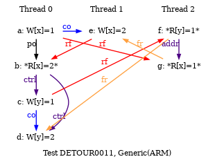

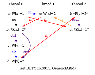

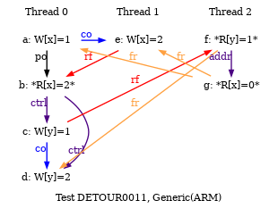

Test DETOUR0011
ARM DETOUR0011
"DetourW DpCtrldW Wsi Rfe DpAddrdR Fre"
Cycle=Rfe DpAddrdR Fre DetourW DpCtrldW Wsi
Prefetch=0:x=F,0:y=W,1:y=F,1:x=T
Com=Rf Fr
Orig=DetourW DpCtrldW Wsi Rfe DpAddrdR Fre
%x0=x; %y0=y;
%x1=x;
%y2=y; %x2=x;
 P0           | P1           | P2              ;
 MOV R0,#1    | MOV R0,#2    | LDR R0,[%y2]    ;
 STR R0,[%x0] | STR R0,[%x1] | EOR R1,R0,R0    ;
 LDR R1,[%x0] |              | LDR R2,[R1,%x2] ;
 CMP R1,R1    |              |                 ;
 BNE LC00     |              |                 ;
 LC00:        |              |                 ;
 MOV R2,#1    |              |                 ;
 STR R2,[%y0] |              |                 ;
 MOV R3,#2    |              |                 ;
 STR R3,[%y0] |              |                 ;
exists (0:R1=2 /\ 2:R0=1 /\ 2:R2=0) \/ (0:R1=2 /\ 2:R0=1 /\ 2:R2=1) \/ (0:R1=2 /\ 2:R0=2 /\ 2:R2=0) \/ (0:R1=2 /\ 2:R0=2 /\ 2:R2=1)
