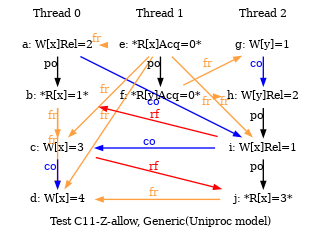

Consider this C11 forbidden execution:
,-> a:Wsc x=2 ,-> d:Rsc x=4 ,-- f:Wrlx y=1
| b:Wrlx x=3 / e:Rsc y=1 <-rf-' g:Wsc y=2
| c:Wrlx x=4 -rf-' h:Wsc x=1
'--------------------------co------------------'
mapped to AArch64:
,-> a:Wrel x=2 ,-> d:Racq x=4 ,-- f:W y=1
| b:W x=3 / e:Racq y=1 <-rf-' g:Wrel y=2
| c:W x=4 -rf-' h:Wrel x=1
'--------------------------co-------------------'

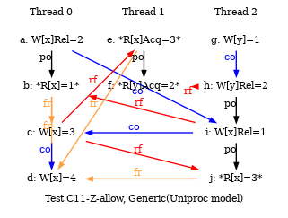

We use the satisfied load-acquire token to forbid this execution. But at
the same time we want a similar execution that differs only by the co-order
of x, 2;1;3;4, to be allowed as it is allowed by C11.

Observed
y=2; x=4; 2:X4=3; 1:X4=2; 1:X2=3; 0:X5=1;
and y=2; x=4; 2:X4=3; 1:X4=0; 1:X2=0; 0:X5=1;
